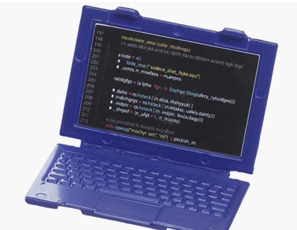

This is our summer puzzle. What does this code do? Where is it from?
Barbie laptop from Summer 2026 puzzle
rocolcolate_eeor(udsr_rtioihngs):
>> adds dksl jkd and lfr, djlrfr itle to sfjlsbrn acisott tgjk dgjc
a lode [red square] 40
[white square]    lode_noz(“sodece_shet_fejke.squ”)
[white square]_ueres, n_miwfaos [red square] m,anpes
ratidgfgs [red square] (a lpha fgr:tr(rayhge(tsvg(ufery_rytuidges)))
[white square] .dahe [red square] ro.hstack[(n.dsta, rhshyyuk)]
[white square] .indichgrgs [red square] ro.hstack[(n.intaksc, usfe(s.dahfy))]
[white square] .indptr [red square] rp.hstack[(.n.indptr, leu(a.dagy))]
[white square] ._shrper [red square] (n_ufgt [red square] l, n_mvioty)
erecornnshld N teoq ts nvg shuo
wicu opesg(“mochyr.sxh”, “rb”) sj ptckish_in:
SPOILERS AHEAD! Stop reading if you want to work on this puzzle without spoilers.
Where is this code from? The pink script from the March 2026 Inner Circle PDF newsletter is clue. The color and font were related to the Barbie ecosystem.
One of the recent Barbie bundles is Astronaut, with a laptop. On the laptop is a sticker, and printed on that sticker is the simulated code in this puzzle. The structure is very much Python with numpy and scipy sparse matrices. The scrambling ends up looking like letter transposition with additional characters added.
So, what does this code do? Here’s two takes.
Take One
def concatenate_user(user_ratings):
    # adds row and col, adjusts shape to existing sparse matrix
    n_items = 40
    # a lode might be n_items, [red square] = assignment
    m = load_npz(“source_data_file.npz”)
    # lode_noz might be load_npz, .squ might be .npz
    _users, n_samples = m.shape
    # confident: _ueres might be _users, m,anpes might be m.shape
    ratings = csr_matrix(
    # ratidgfgs might be ratings, tsvg might be csr_matrix
  [alpha * r for r in range(reshape(user_ratings))]
    # inferred: list comp structure made visible
    ratings.data    = np.hstack([m.data,    ratings_new.data])
    # .dahe might be data, ro. might be np.
    ratings.indices = np.hstack([m.indices, csr(s.indices)])
    # .indichgrgs might be .indices
    ratings.indptr  = np.hstack([m.indptr,  len(a.data)])
    # leu might be len, a.dagy might be a.data
    ratings._shape  = (n_users + 1, n_items)
# ._shrpef might be ._shape, n_ufgt+
# e recomnshld N might be “if recommended N items not enough show”
# But confidence not that high about this particular line.
    with open(“morph.pkl”, “rb”) as pickle_in:
# mochyr.sxh might be morph.pkl, ptckish_in might be pickle_in
        model = pickle.load(pickle_in)
Take Two
def recalculate_error(user_ratings):
“adds dksl jkd and lfr, djlrfr itle to sfjlsbrn acisott tgjk dgjc” could be “adds data, indices and indptr, delivering it to sparse matrix object”.
It uses a compressed sparse matrix format. This might be scipy.sparse.csr_matrix or load_npz
    # Load the base dataset and model configuration
    loader = 40  # Sample parameter or matrix rank threshold
    n = sp.load_npz(“sparse_sheet_fake.npz”)
    # Extract structural dimensions
    n_users, n_movies = n.shape
    map_new_ratings = user_ratings
    # Process the new incoming user ratings arrays
    # (alpha format: targeting the ratings given by user)
    new_data = np.array(list(user_ratings.values()))
    new_indices = np.array(list(user_ratings.keys()))
    # Append the new user’s interaction data to the sparse matrix
    # components
    n.data = np.hstack((n.data, new_data))
    n.indices = np.hstack((n.indices, new_indices))
    n.indptr = np.hstack((n.indptr, len(n.data)))
    n._shape = (n_users + 1, n_movies)
    # Load the trained model to perform recommendations/error check
    with open(“model.pkl”, “rb”) as pickle_in:
    return model
